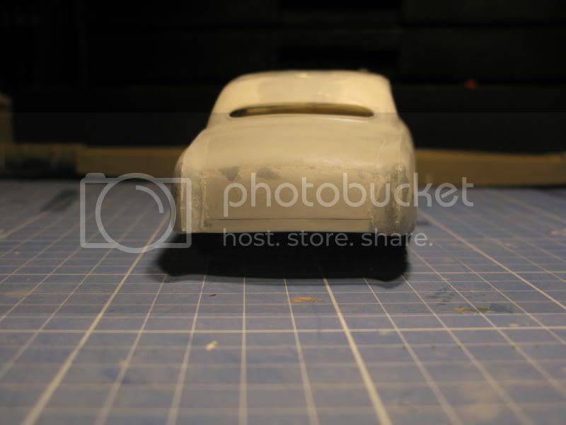

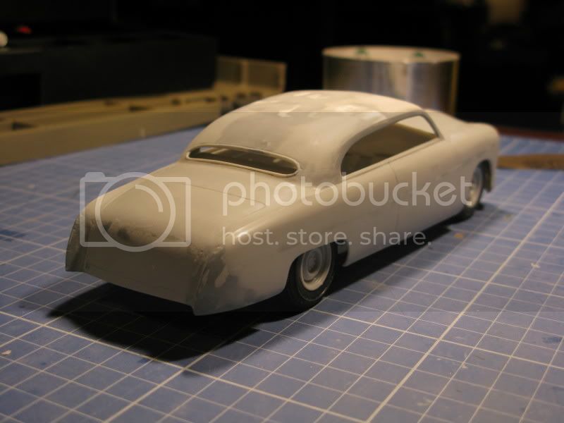

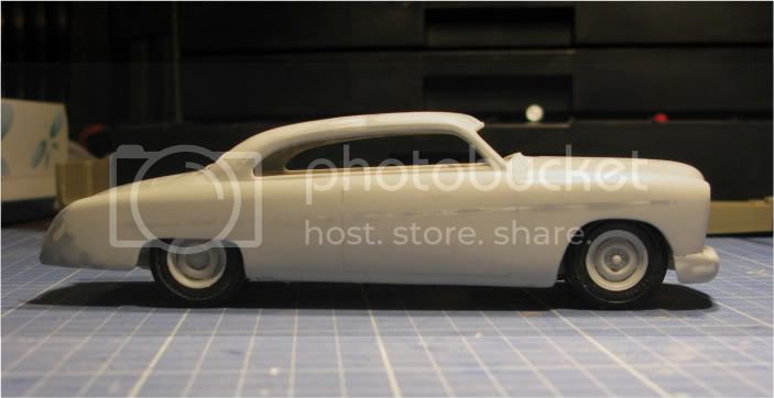

What I did to the rear of the car? First i removed 7mm in height (sectioned), removed 0 mm of the front of the car. I like the wedge look in cars. Then I cut lose the bootlid in the middle of the curve, and then I angled the lower part to match the "fins" that was made from putty.
The top is also chopped more in the rear than in the front. (6mm rear, 2mm front) This also to make the car more "wedged".

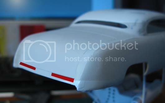

Biggest problem is what to do with the rear lights? Don't want to cut the fins. One of the ideas still cooking is making the rearlights like a strip following the lower edge of the bootlid. See picture. Please help my brain with the rear light problem!

why not "french" them into the fins?

Beautiful work on the Ford. It's going to be one nice custom when completed. The strip type tail lights are an excellent idea. Shaped red plastic sprue (clear type that comes with tail lights) would work or if you can find an old type of toothbrush that was made with the old clear red plastic. Then cut, shape and polish the pieces. The new lights can be cemented with epoxy glue.

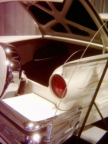

Why not do modern caddy like tailights? You know, where the "verticle section" of the fin is a taillight.....just a thought.

Can you please post a picture or a link to a picture, not sure I understand? (I'm a bit slow sometimes )

I like the profile you have achieved from the chopping. Its kind of mean looking.
