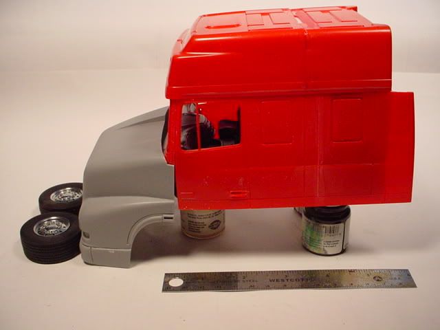

Here I have the stretched cab and hood...this thing is gonna be a monster since the main cab is 6" long itself as seen by the 6" ruler there.

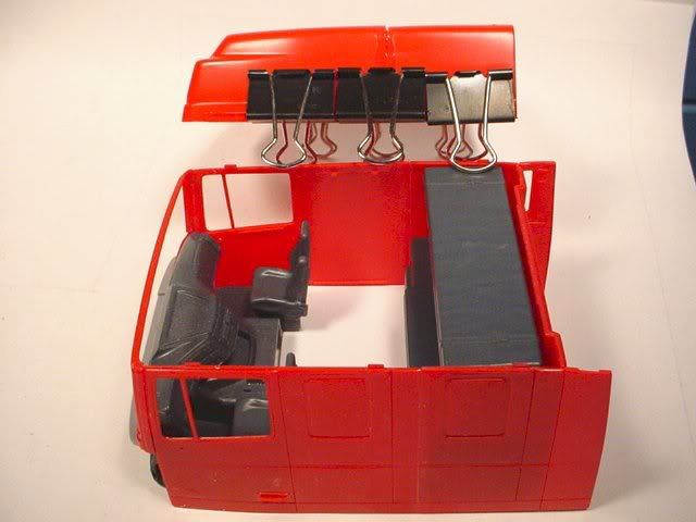

Here's the started interior shot showing all the room now afforded by the stretch and the pieced roof up top - that'll require some smoothing and filling yet. The clamps are holding in the inner strengthening strips and there's a top one too. If you look, you can see the repeting panels that I doubled up on...my cut was just behind the door on one cab, and another like piece was added behind it. The pattern is full panel plus 1/4, then repete...pretty simple for this stretch. DAF lends itself to that while the Scania's don't so easily.
Another shot of the interior with a scratched floor and pilfered parts from the old short interior.
