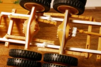

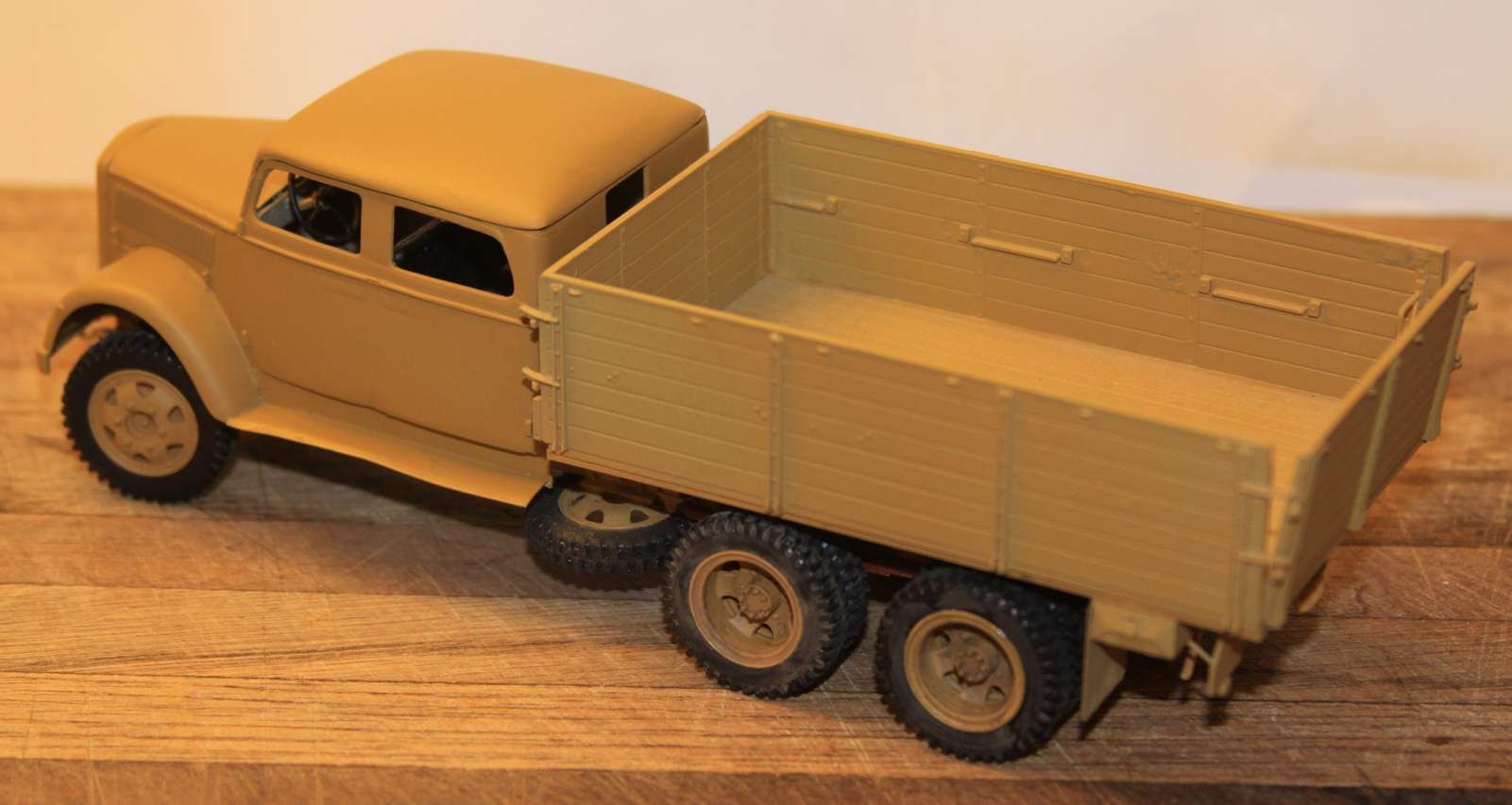

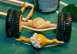

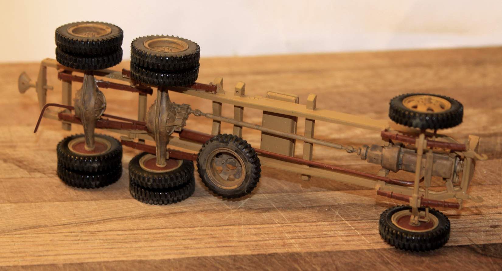

Just tossing this out there as an idea starter:
I always wanted to do a three axle Blitz and that seems to make sense for a car carrier. I came up with a unusual suspension that was based on stock Opel Blitz parts. (But of course such a build would require buying a second Blitz kit.) Also how about a crew cab for you car hauler?
That #2 axle has been modified with what I call an "over the shoulder" gearbox to allow one driveshaft to transmit power to both rear axles. The secondary driveshaft between the two rear axles has yet to be added.

Joel - my 3-axle Blitz "experiment" is just something I knocked together some years ago and again I only show it here as an idea starter for a possible 3 axle car carrier.
The second kit would be required to provide the third axle, the suspension parts and the additional doors and roof section necessary to build the crew cab.

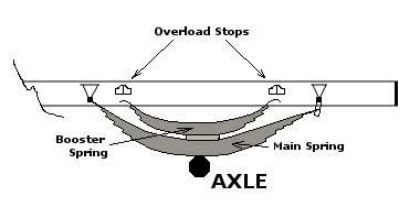

This might be an over the top detail to add but . . ..
Maybe add the rear end booster springs present on all late war Opel Blitz. (Don't know about post-war.) These additional springs raised the load rating on the Blitz to well above 4 tons.

On a mostly unrelated note; the Russians converted some captured Blitz trucks to three axle. With the last axle being an idler - meaning it carried load weight but was not driven. (Like modern Greyhound buses.) I think they supported that last axle with half elliptical leaf springs much like those used on the Panzer II tank. This allowed that third axle to not interfere with the stock Blitz rear suspension or driveline.
