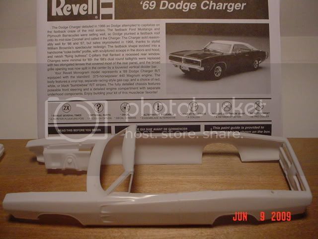

I'll go and take some pics in a minute, and I'll upload them tomorrow-
Posted: Tuesday, June 09, 2009 - 04:21 PM UTC
Why put off tomorrow....

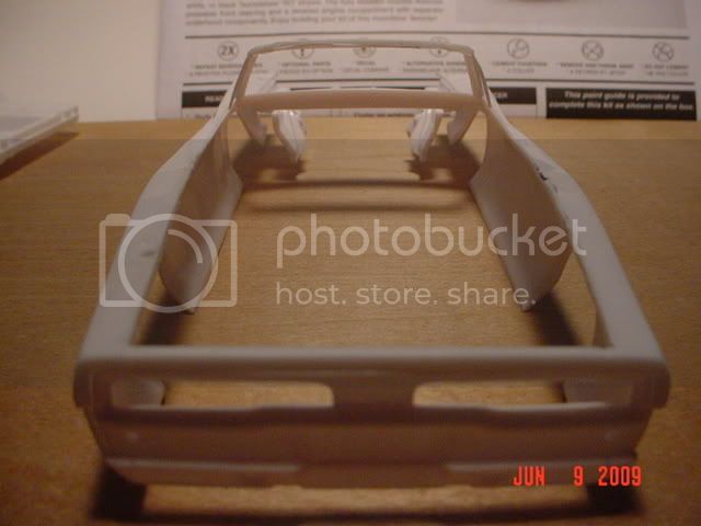

-Here's the rear view with the bed opened up-
-Here's the side shot...possible wagon build?
-Here's a top/side view of the opening...seems large enough but it'll only be roughly 51/2 to 6 feet long inside.
-Here's the chopped interior tub...the hole over the axle is because I'll need the depth for a low enough bed and there was a raised section there...was!
-Here's with two pieces temporarily set on for the idea of the bed floor...needs to go down alittle more up front.
Well, that's where I stand so far on this adventure, but it's good so far. I'll probably have to pie wedge the back of the roof piece to fit wider over the body, but not too wider.

Posted: Tuesday, June 09, 2009 - 04:40 PM UTC
Bob, thanks for the beginning of a SBS there...and showing me that maybe, just maybe, this is possible! Hmmmm....you got my old brain turning over now.....
