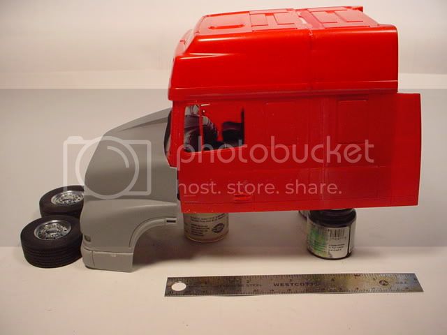

Here I have the stretched cab and hood...this thing is gonna be a monster since the main cab is 6" long itself as seen by the 6" ruler there.

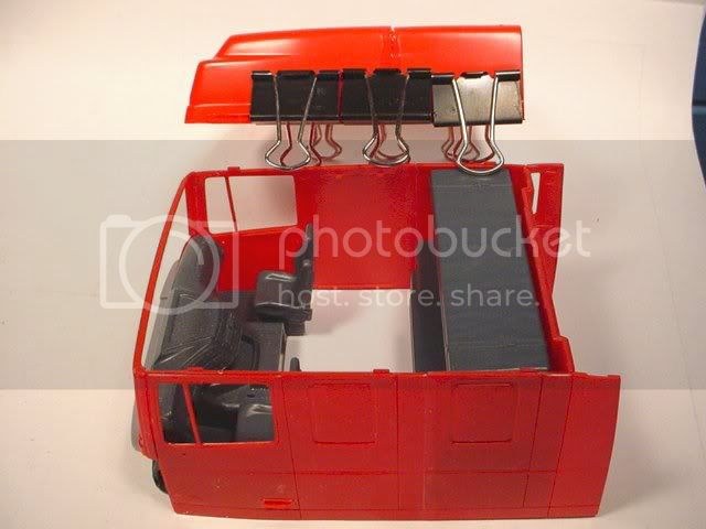

Here's the started interior shot showing all the room now afforded by the stretch and the pieced roof up top - that'll require some smoothing and filling yet. The clamps are holding in the inner strengthening strips and there's a top one too. If you look, you can see the repeting panels that I doubled up on...my cut was just behind the door on one cab, and another like piece was added behind it. The pattern is full panel plus 1/4, then repete...pretty simple for this stretch. DAF lends itself to that while the Scania's don't so easily.
Another shot of the interior with a scratched floor and pilfered parts from the old short interior.

The roof is nearly done, just have to add the rear air dam and blend it in.
Had to tweek the hood to clear the interior pan up front as well as blend the hood better to fit near the windshield...opened up the front two scoops too while I was at it-

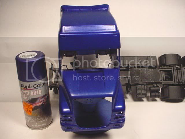

Alrighty, we got not only a cab done, but some color as well. Put a light coat on early today and then a decent coat this afternoon....now to let it dry fully and wet sand 1/2 of it off to get it smooooth. The color in question is chrysler company electric blue pearl and I'm toying with a silver swoosh on the side of the cab as well.
Now I'm thinking a red chassis might be in order.....
