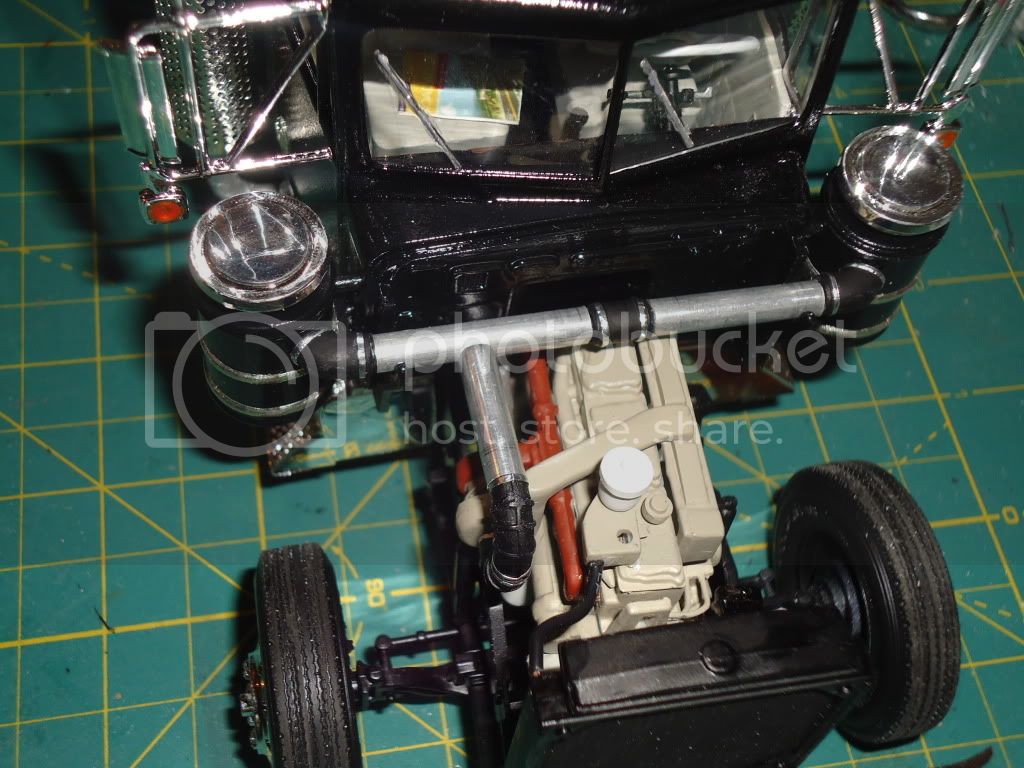

What I've done for bending aluminum elbows is find some plastic rod stock that fits snug in the aluminum tubing and bend the stuffed section slow and easy. Another thing to try is brass tube that's been tempered down...heated till orange. Then stuff and bend that...you can prime and alclad chrome it when done...that's what I did for my chopper build pipes.
Posted: Friday, October 29, 2010 - 03:03 PM UTC

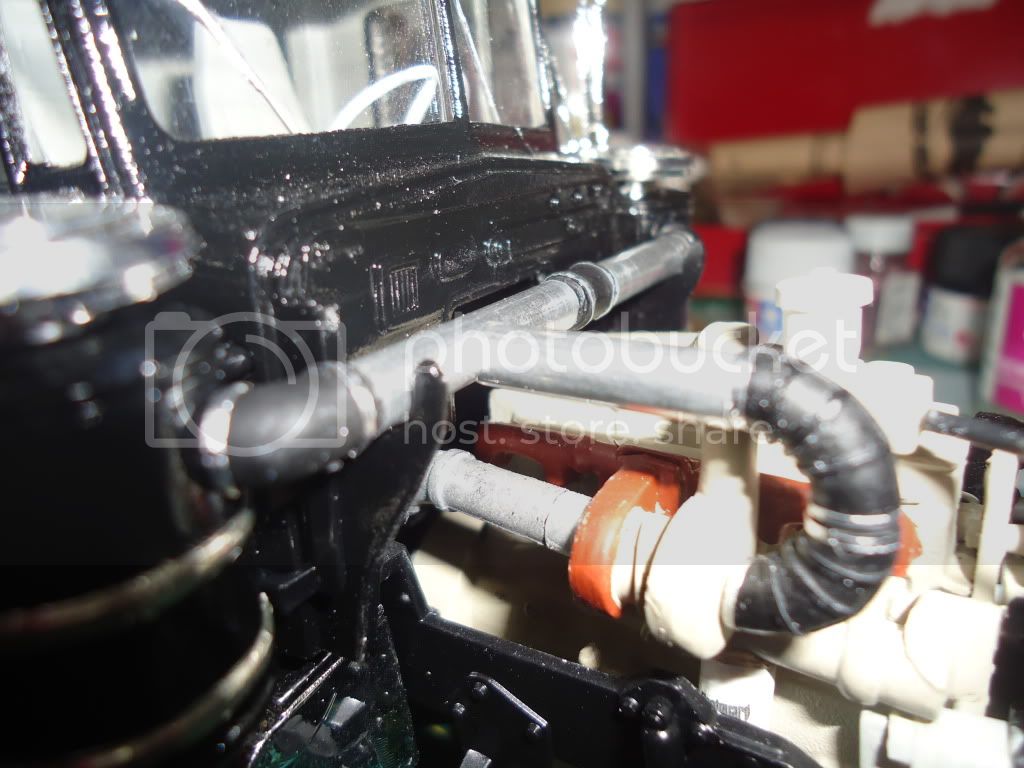

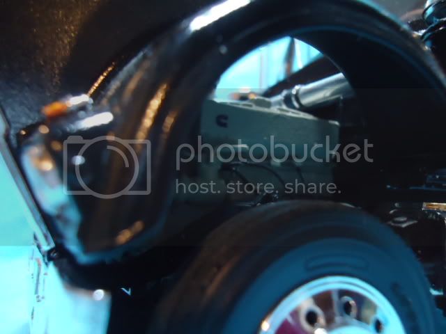

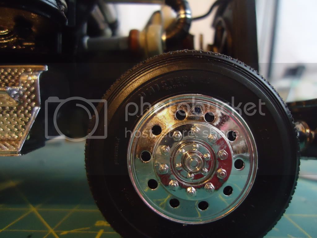

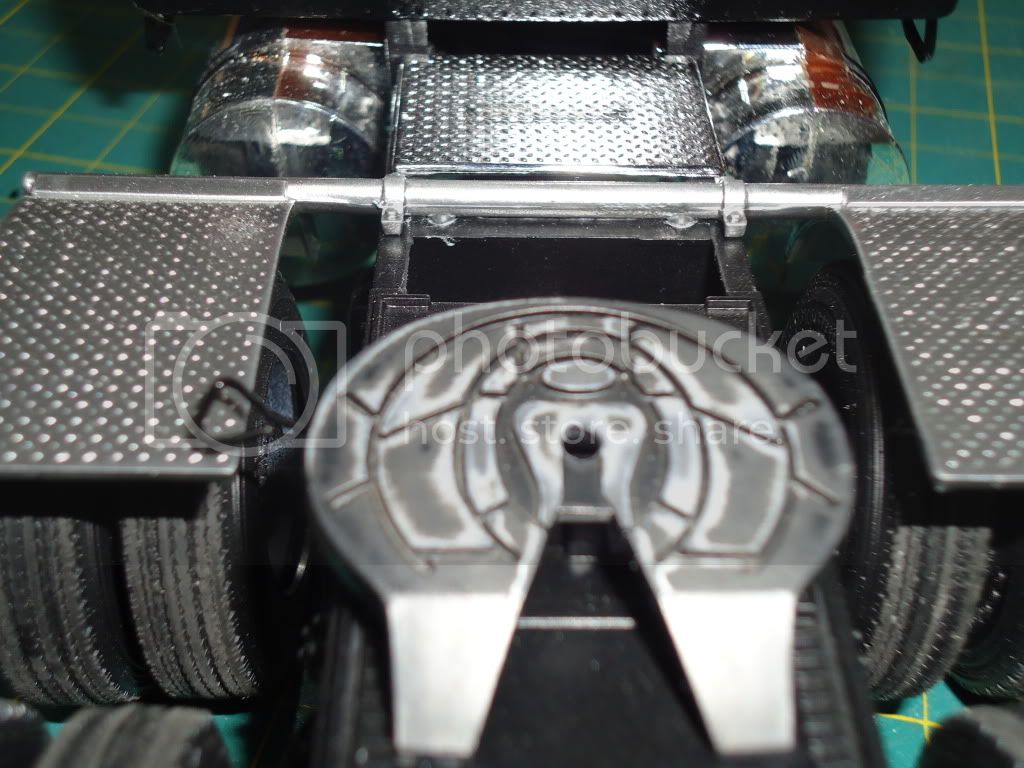

Ok, so not much has happened since the last update, but I did manage to replace the air intake system with aluminum tube, scratch build some 90deg elbows, got the "Alcoa Wheel" logos on the front wheels, and make a fifth wheel release handle. It's not much, but it's something.
Posted: Saturday, October 30, 2010 - 12:58 AM UTC
Looking great Jim. Very nice work on the air intake tubes as well.

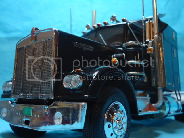

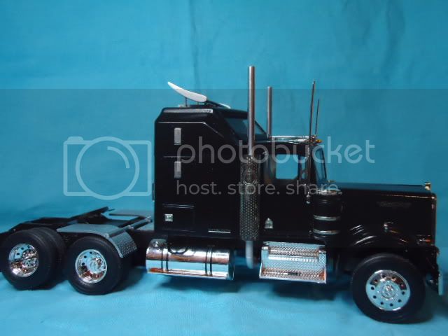

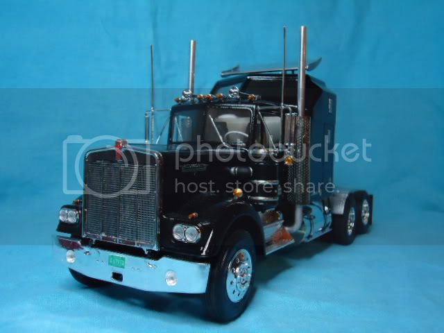

Well, I'm calling her done! I managed to get the wing on the roof of the sleeper, and the turn signals on the fenders. The wing is from Eric (Porky), and has been cut down to 72" wide. The bracket is scratch built, and isn't too bad for a first attempt.
I wanted to put a drop visor on it, but all the ones I made didn't look very good. I have another one of these kits down stairs, maybe I'll see if I can get a visor that looks decent. We'll see.
If I get some decent weather tomorrow, I'll try to get some outside shots with the Fruehauf tanker.
I like this shot!

Posted: Wednesday, November 03, 2010 - 05:53 PM UTC
Hi Jimb,
Nice looking truck. The paint is really nice. I just picked one of these, and I'm pleased to see they build up so well. Not having a lot of luck finding Duplicolor here in Indiana, so I'm gonna try some Krylon that the local model car guys say works well.
How nuts do you truck guys get with seams. I practiced on a spare tank and pretty much ruined the chrome smoothing out the mold line. So that may become a painted tank. It came from the KW T900 Australian and I didn't want to mess up the long tanks. I'm familiar with the old school silver paint , thin strips of chrome foil, but are there any new techniques I've not heard of ? I dug out a 20+ year old 1/32 R-M snapper and it appears I wasn't too worried about seams back then.
Is it me or was anyone else not real happy with the fit of the parts on that KW ? Maybe I'm spoiled by the fit & finish of the military kits (Tasca,Bronco & Hobbyboss) but for a $60 kit I thought the parts would fit better. I guess I've been away from trucks too long.
Lastly now that I have a beautful primed seamless tank does anyone have a suggestion for natural aluminum (unpolished) look ? Any help would be appreciated.

Jake,
Thanks for the compliments. Glad you like it.
Kind of suprised that your having trouble finding Dupli-Color in Indiana. I can get it here in New York at NAPA or AuroZone. I've had some good luck with Krylon, too.
As far as seams go, it sort of depends on the builder. If you look at the pics of this build, you'll see seams on the tanks. I didn't do anything with them because I knew I couldn't get the chrome back the way I wanted it, short of sending them out to be rechromed.
As far as painting them, you can get a good "brushed aluminum" look by using automotive chrome paint. That's what the wing on this build is painted with. Depending on how you undercoat it, depends on the shine you get. The wing was painted gloss black first, then shot wuith Dupli-Color Bumper Chrome. (There's that Dupli-Color again). If you have an airbrush, you can try an product called Alclad-II. That paint is amazing! Stuff really looks like chrome.
As far as the fit of truck kits, what you got to remember is that the molds for most of these kits are between 30 & 40 years old. There hasn't been a new truck kit issued since the AMT Kenworth T600 in the early 1990s, and even that used molds from the 1970s. (Don't get me started on that kit.) I have yet to build any of the Revell of Germany kits, but I do have several in the stash; and from what I've heard the fit better than the AMT kits. Ok, that's not saying much; but it's something.
So you know, Moebius Models is making the first all new truck model in 20 years! It's the 2010 International LoneStar! And it should be out Spring of next year. I've seen the pre-production model on another board, and this kit is absolutely incredible!! The level of detail in a 1/25 kit is something you've got to see to believe. The guy that built the model said that the kit just "fell together". I am REALLY looking forward to getting that kit. I hope Moebius issues more modern truck & trailer kits. They would be very welcomed in the truck modeling world.
