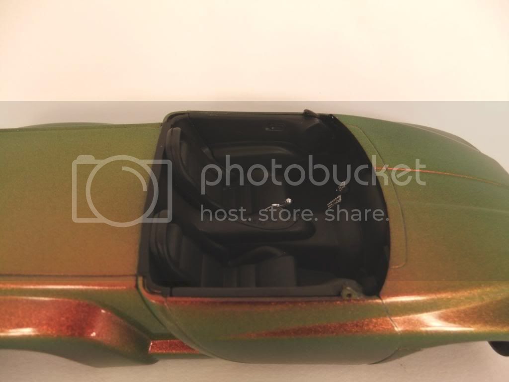

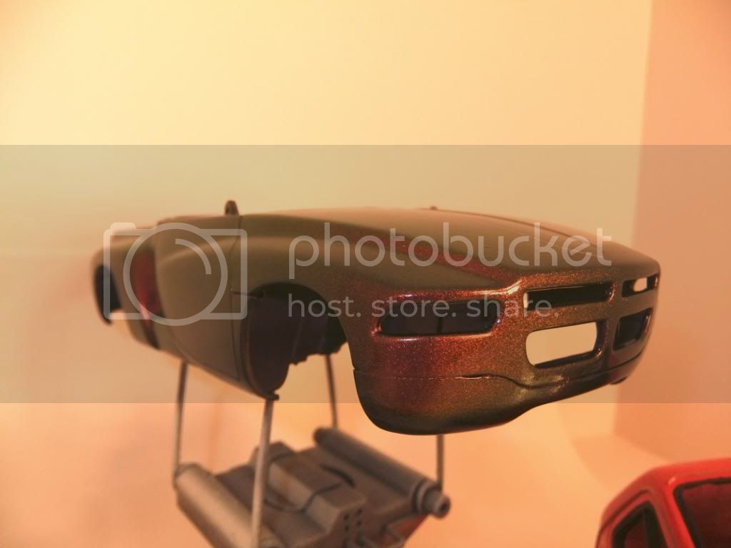

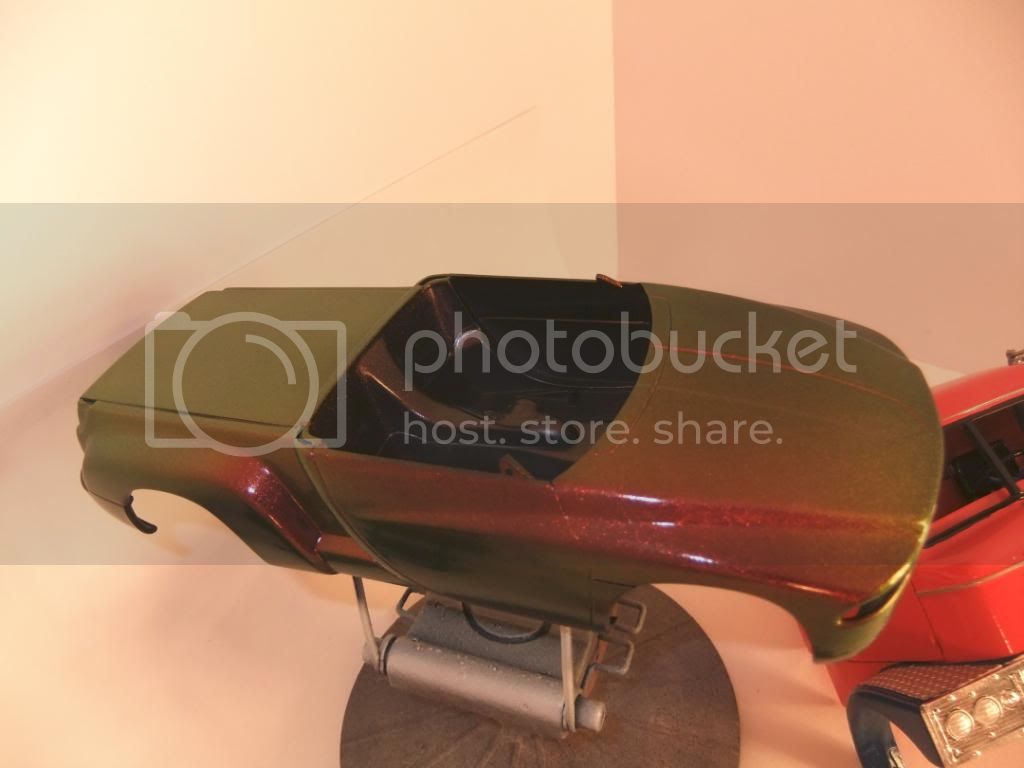

I wanted to try out some alcladII color change paint I've had sitting around and this was the result....it's alittle hard to see in the camera's eye the color change from redish copper to green...but it does it! My kids said that paint can't change color...so naturally I had to show them it could.
Oh, this truck has a base coat of 3 mid coats of sealing primer{lacquer paint!} that was 2500 wet sanded between, tamiya's gloss black base spray{pretty darn sure that's acrylic lacquer since it's foam safe} that was wet sanded with 2500, then 3 light coats of the flipflop color of alcladII's prismatic maple{copper red to green}...No wet sanding here or it'll screw up your color changing!, then 3{so far!} coats of clear testors lacquer which will be wet sanded later today then get more clear on top of that....I want it to look deep.
The rolling chassis has been done, the motor is for another campaign build so she's a curbside now, and the top and interior are just about all that's left{oh, mirrors too - won't be body color}

Wet sanding the color change coat is a big no-no but every other coat{primer/base/clear when there's enough on to not sand thru} is ok.
When the color change coat went on it was almost flat, but it's humid as heck around here so maybe that's why. The 1st clear coat over it brought it back out to shiney-ish and made it really pop! Every clear coat afterwards{2 so far} made it better.
I used this red to blue rattle can system for the flames on my kid's peddle car....turned out really nice...but that's not a model.
One doesn't need an AB to do all of these color change paints...house of color makes a nice system of base/color change color/clear{3 different cans} and it's in rattle can form!
I picked this vehicle because of it's curvy body to pull out any color changes...and it does.
Grab a good model and some color change paint and go for it!

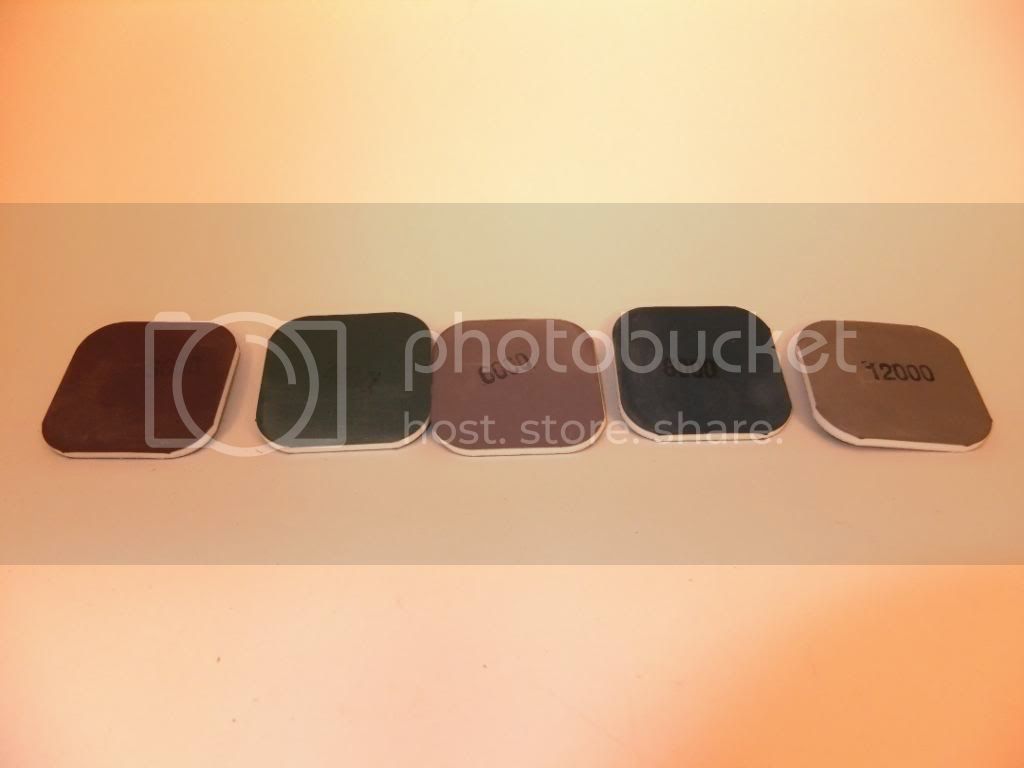

Alright, I tried something different here and it worked out very well...I used the Steven's International paint polishing pad system{roughly $10 and some change}...this stuff works great! I recommend this to anyone wanting a smooth glossy finish.
Here's the 5 pads you get- 3000, 4000, 6000, 8000 and 12000 grit.

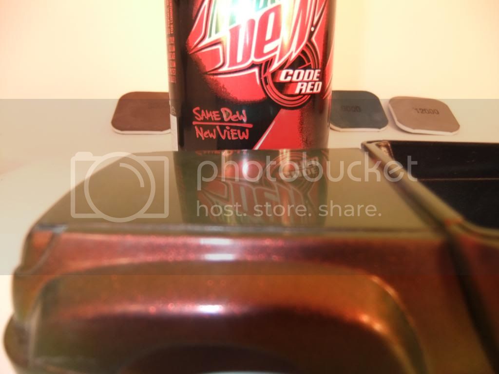

Here's the results from the origonal slightly orange peeled finish-
This is all shine and no polish or wax yet...color me impressed!

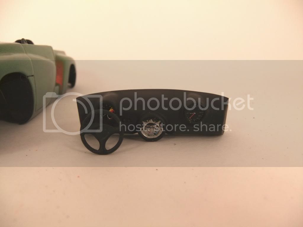

-Here's the dash..the decals started coming apart on me when I was installing them...yikes! I patched them up as best I could and touched up the lil nonexistant areas.

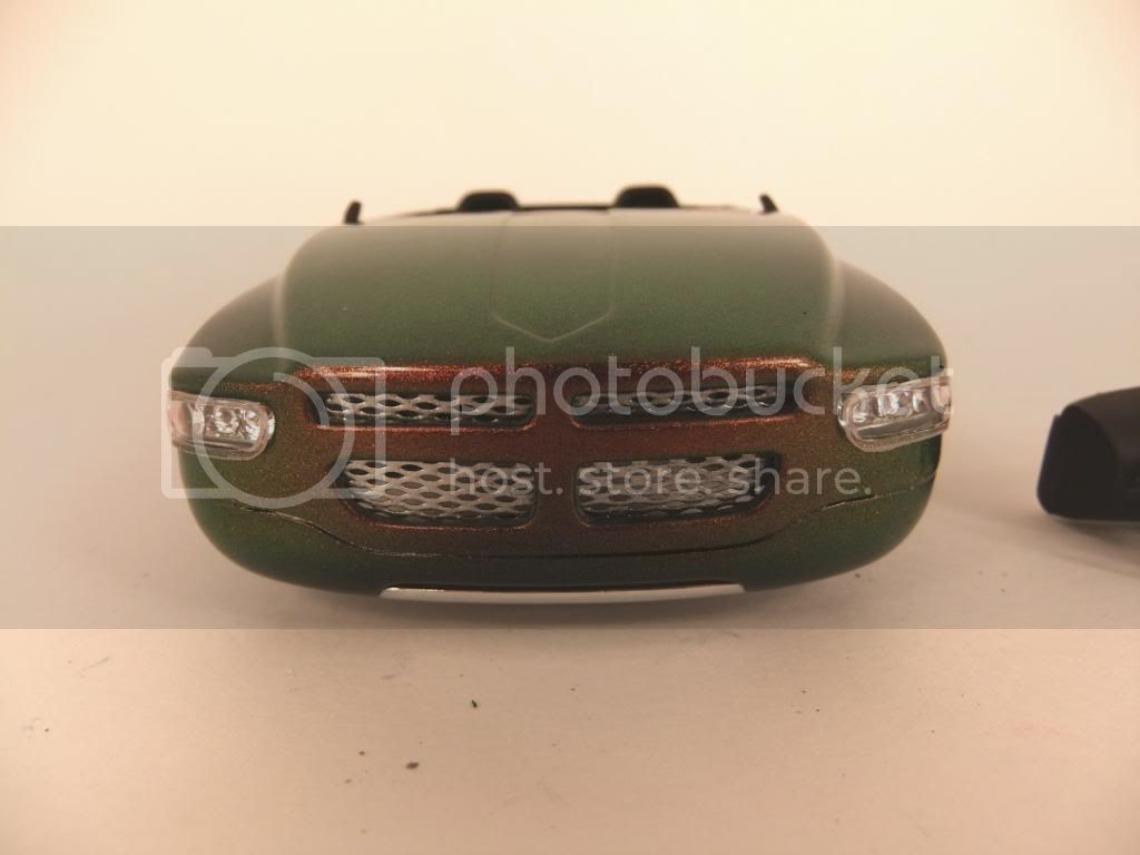

-Here's the new grill mesh-
