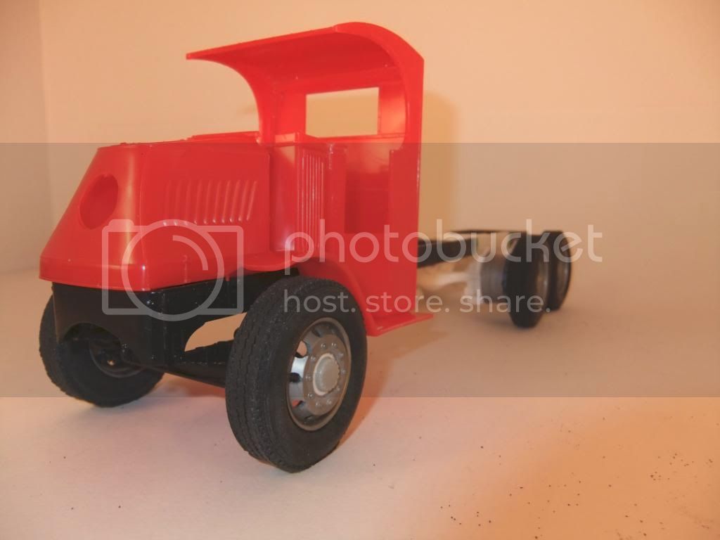

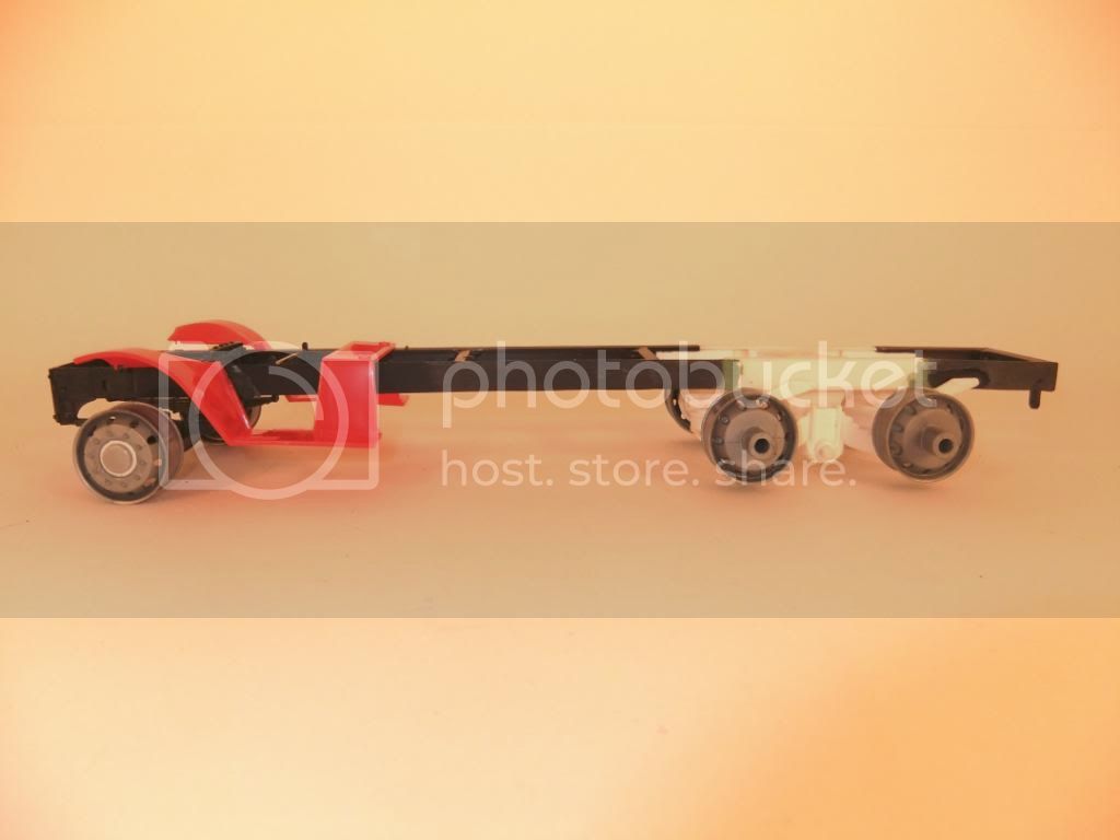

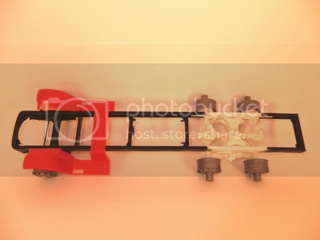

Here's one I'm sneaking in from left field...my rendition of a Mack AP using two of the current Mack AC tanker kits. I've stretched the frame by 5 feet for a 16' wheelbase...17' is the official "long" length chassis but this is a factory custom build so since it's "my" factory...
I used the mack r685 dual drive unit for this build because it closely resembles the early mack duel reduction gear drive that was also available back then - not just chain drives for the APs. I'll be using the kit 4 cylinder engine but back then you could get the 6 cylinder with the slightly longer nose/hood...I'm going for the easier way this time so I don't have to make a new hood.
Also, you will note the use of the italeri rims for this build...interesting thing...mack had similar rims back then with the exception being that they had 8 holes{2 large/6 small} while the italeri rims have 10 holes{2 large/8 small}...close enough for this build and for me. Besides, it'll match the trailer tanker rims now too....ooops - did I let that out early?!
