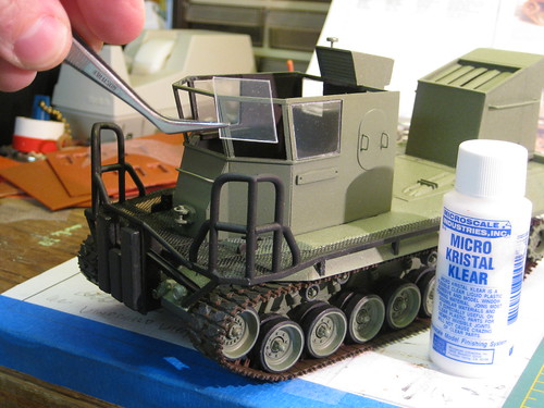

What I use is clear styrene sheet (or I really slum it and use toy packaging plastic but that can be noticeably wavy), cut to shape with lots of test fitting and trimming a little at a time. Here is an example that used simple flat windows.
To install, I put a generous bead of that Micro Kristal Klear (or again, go cheap with Elmer's School Glue, both dry clear) around the window edge. A neat thing about the Kristal Klear is that it smooths over gaps, even creating a window by itself if you spread it across a small opening.
