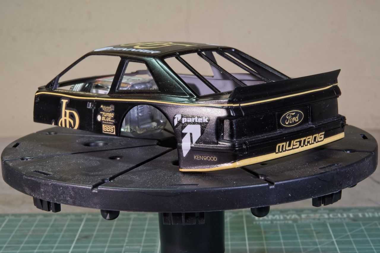

Back in the early 1990's Revell molded the 1986-1989 Roush Mustang, that was driven in both the IMSA GTO series as well as the SCCA Trans AM series with different drivers for different sponsored cars. This kit started out as the Black JPS Mustang, but I decided that I wanted to do the Folger's IMSA GTO sponsored car. Bill Elliot and Ricky Rudd drove this Roush Ford Mustang to a 5th place finish at the 1986 12-Hours of Sebring. What makes this even more interesting is that both drivers are Nascar stock drivers, and were excellent road racing drivers as well who dominated the then 2 road races per season.

I've decided not to follow the kit instructions, and instead opted to paint, decal, detail paint, and gloss coat the body shells 1st.
I bought the kit on ebay and it was opened and tinkered with, but it looks like all the parts are there. The body shells were really scratched up, so I had to spend considerable time sanding & polishing them to get ready for primer.
