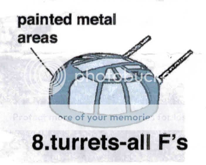

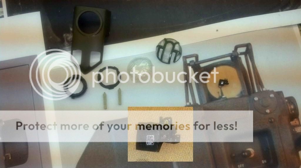

This is a brief update on my work on the top turret. Below you can see a collage of modified turret parts, mostly from thr Monogram G kit, against a background photo showing the rear of the Sperry K-3 gunsight, and an inset showing some gunsight detail.
You can see how I modified the shapeless kit gunsight -- from the rear. I didn't realize until the picture was taken that the data plate was a bit off-center. I will replace it with a smaller decal later, and also show you what the front and top of the sight look like after modifications.
Going back to the main picture, I removed the center from the top turret ring, where the guns, gun feeds and sight were. The resin gun bases pictured are from the Verlinden set: I already drilled out the holes in front for the Karaya metal barrels and blast tubes.
Next, take a look at the unpainted turret dome and compare it to the real thing, which is the last picture in the prior post. This part is from Bill Koster's excellent "B-17F Nose Job" set. It doesn't look like much unpainted, but when you compare it to the Revell kit part in the picture -- the one I built in the 1980s -- you can see how very different it is. Here is a better picture of Koster's work from his instructions. If you want to do an accurate B-17F, the Koster part is a must!
To free the dome from the vacuform backing, I cut it out leaving a 1/4 inch border around the edge. (None of that scoring at a 45 degree angle around the base for me: too dangerous.) Instead I put the part on a flat sheet of 320 grit sandpaper and sanded the base away with a light circular motion. After a while it thins to the point where it just cracks and falls away from the part. I do like this method.

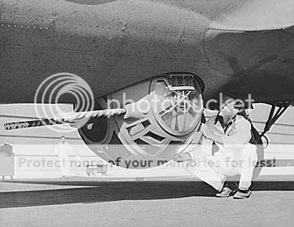

On to the ball turret. First some fresh views of it with some details that are frequently overlooked. First, a forward shot with the shell ejector chute flagged.
Next a shot of the rear with that complex turret side and--hey look!-- an external set of gear teeth showing for the elevation mechanism! Also, the left seatbelt.
Here's what we did for the turret sides:
The final pieces to be attached to the turret sides -- after additional interior details are placed inside the "glass"-- are shown on the left. They were vacuformed over the acrylic curved sides in the center, which we originally were going to use for the sides themselves, but then changed our minds, and defaulted to using them as vacuform molds and a cutting pattern for the vacuform pieces at the top.
