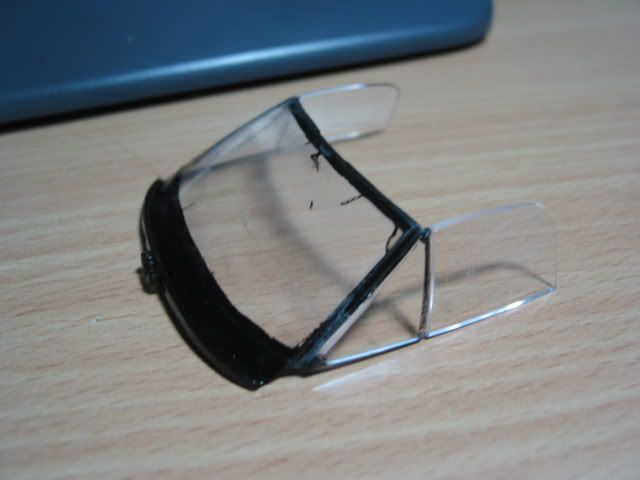

Ralph, for removing the paint, try dipping a Q-tip in some Goo-Gone. It should removie it. I'd test it on a spare piece of plastic to be sure it doesn't attack it. Have used this stuff for awhile and it works well. "Q"

Here's two links on how to paint windowframes.
http://www.briansmodelcars.com/tutorials/tutorial.asp?TutorialID=42&CurPage=1
http://www.tamiya.com/english/howto/car1/tip4.htm

Your BMW looks pretty good Ralph, that windshield is going to be tough to fix, you can try to scrape the paint of with the sharpened wood end of a small paint brush gently sometimes that works assuming its flat black, also try maybe some plastic polish. If that does not work maybe some brush cleaner on rag but that will fog the window then you will have to polish it. To polish your window the Novus polishing system works great on paint and plastic and it will fix that window to. if you don't want to spend money on the Novus system try a real car cleaning wax that may work. I am curious to see how your floor mats turn out. keep us posted. I hope these tips work they have worked for me. Good luck

Windshield painted. OMG it sucks! Any tips on removing that enamel paint on the sides and polishing it to very clear glass? Also, any tips on masking off the windows?
