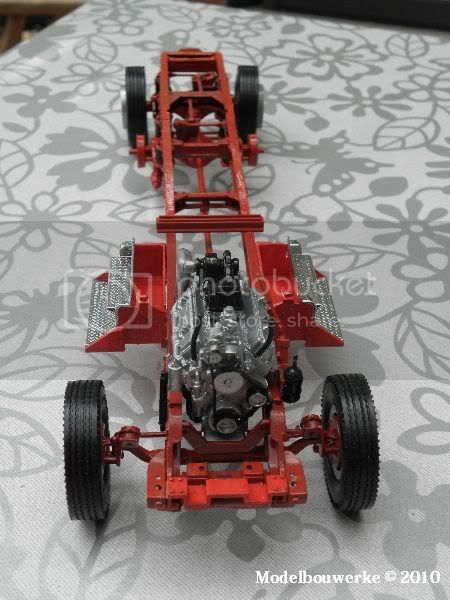

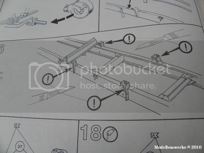

Posted: Thursday, May 06, 2010 - 10:46 PM UTC
Hi.

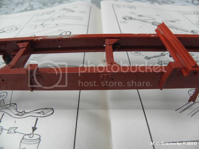

So I started building and discovered that you have to read the instructions carefully.
The chassis was nearly complete and painted, then find out on step 16 that I must cut a few things away.
Why in step 16 and not on step 1 or 2?
This is what append.
Building instruction step 16. 4 pieces need to be cut away
Like is was.
As it is now.

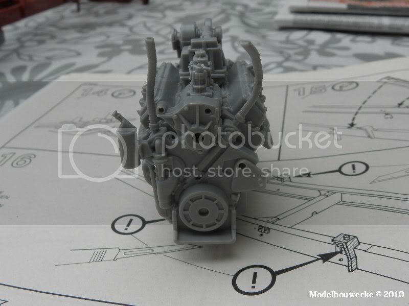

Engine is almost put together and this stage is ready to be painted.
For the moment I'm a little bit sick , means a little bit more time to build

Posted: Friday, May 07, 2010 - 01:14 AM UTC
Looking pretty good. I think those things you cut off were the sleeper mounts. It looks like Revell just used the Kenworth T900 kit for this, and that has the 60" sleeper. Is the sleeper in the box? Wouldn't be suprised.

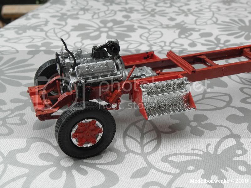

Engine in place.
Overview.

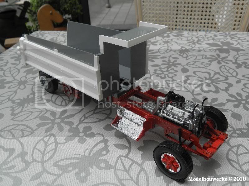

Subframe
Subframe, a dryfit.
Dryfit of the first dumper.

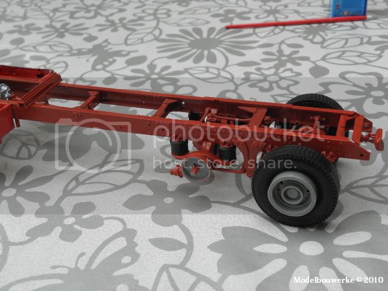

Slowly the build goes on.
There is a rolling chassis on my workbench.
10 wheels, an engine and some chrome.
Decals in place, mudflaps and gastank are fitted.

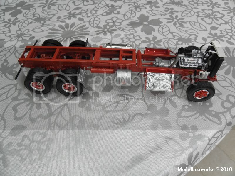

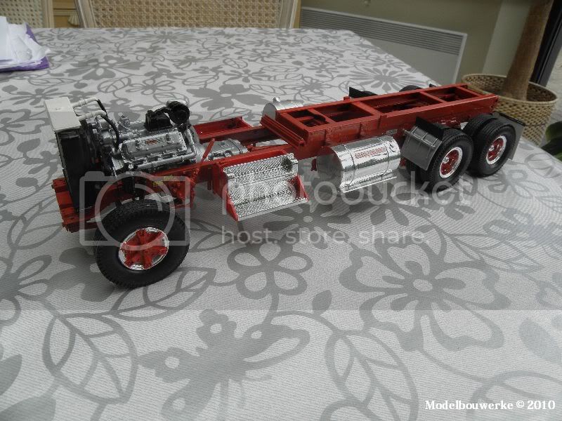

Posted: Sunday, May 30, 2010 - 07:07 AM UTC

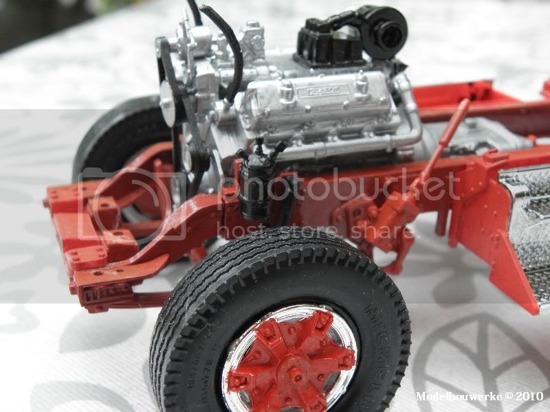

Had a little time to take some pics.
Found a little thing that wasn't good.
Needed to touch up some parts with satinblack.
And here are the pics.

Posted: Sunday, May 30, 2010 - 01:15 PM UTC
Looking great Erik, what paint did you use on the frames?? I like the shade of Red there.
Posted: Sunday, May 30, 2010 - 03:51 PM UTC
Coming together quite nicely. I do have a question though: why is your Caterpillar 3408 silver?
Posted: Sunday, May 30, 2010 - 07:34 PM UTC
Hé Damian, thanks. The paint is "Revell Aqua", in most shops in my neighbourhood for sale. And I like to work with it.
Just followed the building instructions. I also have an other Kenworth in my stash and the engine must also be painted silver. Maybe Revell is wrong and use the colors of modern engines? (The kit is from 1995, modern then)
@ Animal, hope you stay hooked

Posted: Monday, May 31, 2010 - 06:53 AM UTC
Now I'm not a 100% sure but one thing I do know is that a lot of these model company's do get a lot of their information mixed up like to when they had a big V8 cat engine and then they went to describe a 95-13 transmission to which that big engine would tear up that 9500-13, now to what I figure they done was hear about a 9513 transmission but had no idea what it meant but my old Kenworth I had with a small cam 350 Cummins in it and it had a 95-13 transmission because that was the normal for small engines to have a light weight transmission.
Now when you have a bunch more horse power on your engine then the transmission you have has to have a higher number of torque rating to withstand all the torque of the engine because that 95 meant it only has 9500 torque rating now I don't remember all the higher numbers and unless I get out my paper work I couldn't even tell you the torque rating on my Mack 13 speed transmission right now but the only engine I ever seen silver were them 8 V 92 series Detroits they called them the silver 92's and before they went silver they were the same old green color even the newer straight 6 Detroits went back to a off green that almost looked gray and the only colors I have ever seen on Caterpillars was that white on the old 1693 6 and 8 cylinders then the off yellow on the 3406 & 3408 and they stayed this way through the A,B,and C to what all I seen of them until I left the road in 2000.
Now unless you call a Kenworth or Peterbuilt truck dealer and ask if they know if Caterpillar ever had any other colors beside white or yellow because they would be your best kind of information.
