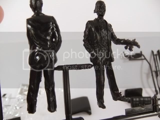

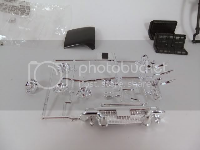

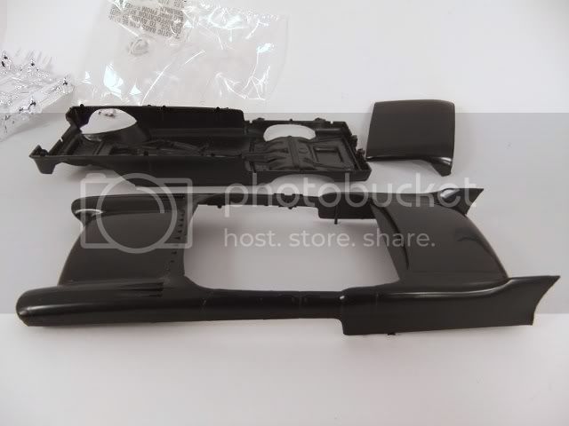

Well...seeing as none of us have X-ray vision and I have the kit, let's see what's all in the box;
-Decals
-Chrome
-Wheels and asst. parts
-Interior floor, note the lathe marks for carpet texture- get some flocking!
-the sharp dressed man{no ZZ Top here I'm thinking}
-the elegant woman in her evening dress
-the body...top and bottom halves and the roof{no boot to make a ragtop}
My eyes can see the sink holes but the camera has a difficult time of displaying them...sorry. Not a bad kit for the vintage or the subject, but she'll need some work to look nice.
Now you know what your getting into with this one.

Mr. old-dragon, thanks for sharing the sprue shots!
I was wondering what the figures looked like because my buddy is looking for a well dressed man figure in 1/25 to represent his father standing next to their (scale replica) family car
Looks like we found it

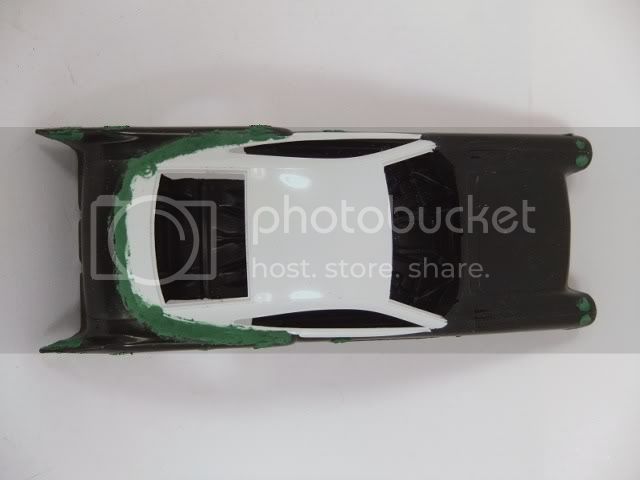

Awh come on now...she ain't that bad. More like an old AMT kit with alot of flash and sink holes...except its a revell.
Now, what I may suggest with this one would be to remake her into a coupe! Yeah, I went the coupe route- I'll be filling in the majority of the old door lines and scribing new ones to render a two door coupe - just to be different.
The top is from a clearance bin Revell Ferrari 612 scaglietti which I bought mostly for the motor and rims...nice to know the body was good for something!
Next time or kit I'll try a roadster...maybe a '62 T-Bird rear deck added.....
You may notice that the top and bottom body sections are glued together so I can smooth and finish the whole body without seems....I will cut out the bottom along the chassis rail lines so I can have access for the interior which may or may not be the ferrari's - I haven't gotten that far yet in the thought process....filling is my current concern/issue. Speaking of filling, I'm thinking of filling in the front top fender depressions just in front of the windshield to give her a smoother look - of course there will be the lower side rear fender scoops to be considered as well.......I still need to fill in the driver's side fuel filler hatch from the donar roof. This will be the good old fashioned rear filler behind the plate.......remember those days?!

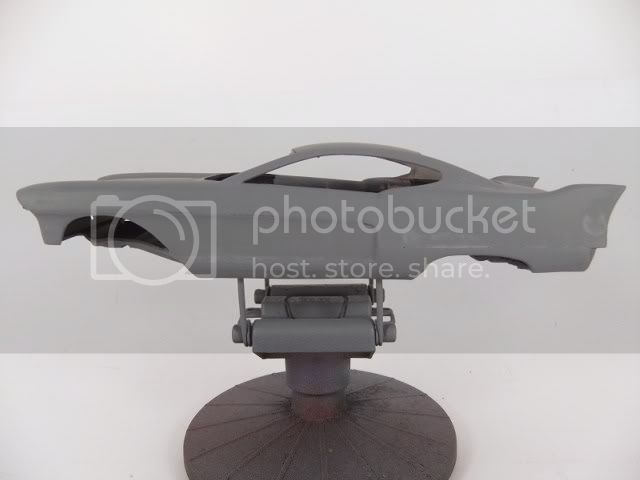

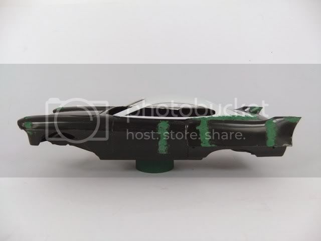

-Body work beginnings;
I'd love to make a windshiled visor, but with that rake it'd be a mile long! Oh well - I'm shooting for a clean build so no wide thin hood scoop, no front visor, no rear cross wing between the fins and no rear window visor....
Most of this 1st coat of primer will be sanded off just to show the high and low spots and any seems that weren't filled...which I now see a few{dang it}.

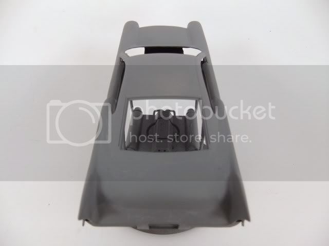

Oh, thought I'd share this with any future builders...note the roof has an "inset" for the windshield...most of the time your windshiled lays inside the body and gets tacked in. This set up has both in the way of it needing to lay in by the hood and yet sit in the channel on the roof.
I got very lucky in the fact that I didn't spread the front pillars too far from origonal so the windshield still fits...you'll need to watch that if you ever swap a roof in and said windshield sits in a channel, so that windshield will still fit afterwards. Too narrow is an easy fix - sand the windshield down on the sides till it does fit the channel again....too wide and you'll be either making a new windshield or filling that in so the donar windshield fits properly again.
Another recourse is to sand out the sit in channel and make a new windshield that lays in from the inside...more fudge room that way too!
Just things to watch out for...
Well...lots more wet sanding and some refilling for me to do....later.
Posted: Sunday, December 26, 2010 - 05:29 AM UTC
I should add this too....while there are different ways to get the body smooth before paint, but a coat of paint will usually show things you missed. Sometimes ever primer will hide something till a shiney coat of paint is applied. I've found that this way of priming and sanding then repriming{repete as needed} till smooth works for me - it does, however, try to fill in the door, trunk/hatch, and hood lines at the same time, so I take out my scribe every time and clean these areas out after a primer coat session. Keeps the lines clean...

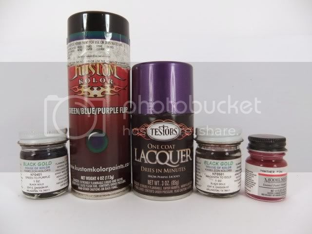

Thank you..."colors" was mentioned recently..here's a few I'm kinda liking at the moment-
The two lil "Black Gold" jars shown are 1:2 ratio{paint to thinner} HoK{house of kolor} flip paints that I got off of ebay for...something, someday...and of course a Pink for consideration since it's a caddy.
In the last set here is the end{RH} Tamiya "White pearl"
...I'm open to suggestions as well and I have plenty more of jar and rattlecan paint to choose from - choices are a wonderful thing unless your unsure what cool color to paint your creation!

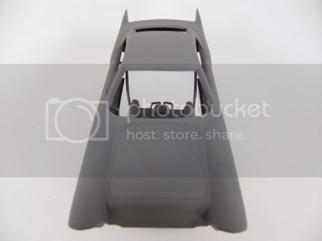

Posted: Saturday, January 01, 2011 - 02:23 AM UTC

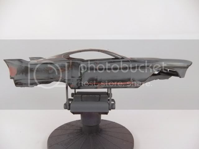

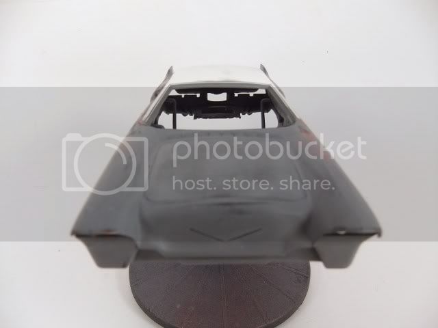

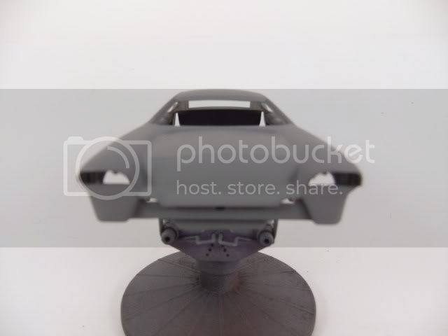

Thank you Jesper and Happy New Year sir. Funny thing the other day - I had taken these now found pics of the car being sanded down but when I uploaded them to my computer they got lost....luckily I found them.
Anyway, here's the body after a thorough wet sanding to smooth things out. I removed the drip/wind rails from the top of the roof for a cleaner look and to make it look flatter.
The rear deck will be the most work trying to blend that all in.
In this process, you will wet sand and re-apply primer till everything blends in with no ripples, marks or cracks....I put the body on the Tamiya spray stand and turn it around slowly while viewing it at different angles to the light{daylight or a strong lamp} to look for any distortions in the reflection off of the body. I then will mark those "need attention" areas with a pencil and keep searching.

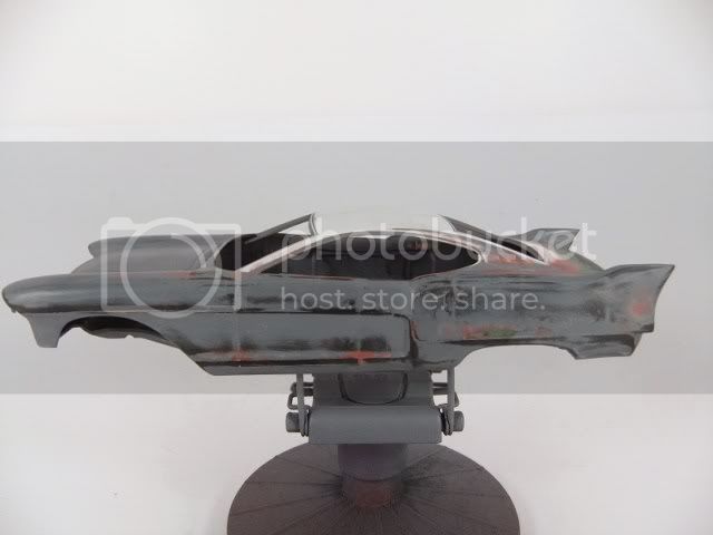

Posted: Saturday, January 01, 2011 - 02:31 AM UTC
Notice on the side scoop areas that run from the front of the car to just past the door - those lines can get alittle soft on you from either fillin or molding so this is your chance to crispen them up by sanding them straight. Roof lines are also correctable this way too...or trunk, fender...well...anything.
I normaly tweek like this about 3 or so times on a given model...sometimes it's less{if I get lucky} and sometimes it's more. Keep tweeking till your absolutely happy as your base here will dictate how well your paint lays or looks on the finished model.

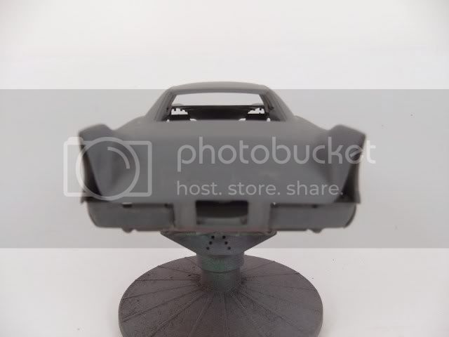

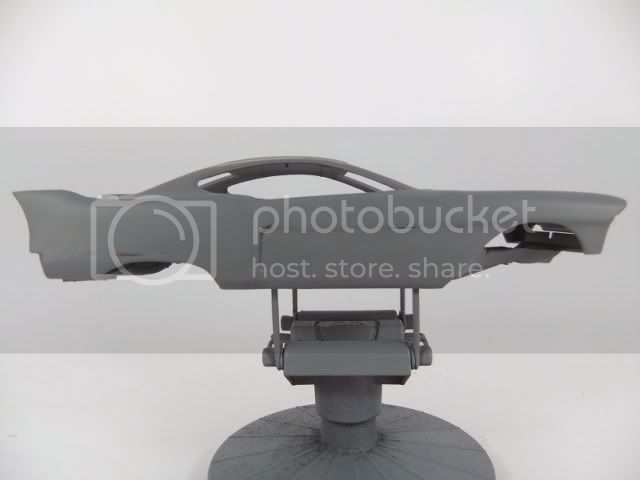

Posted: Saturday, January 01, 2011 - 02:57 AM UTC

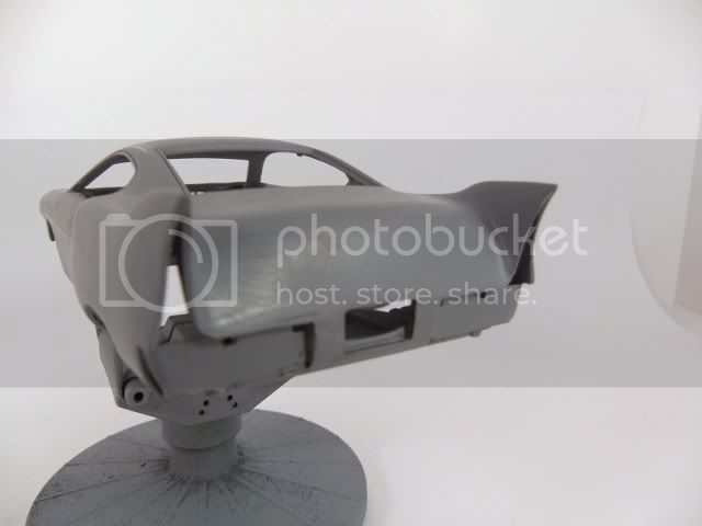

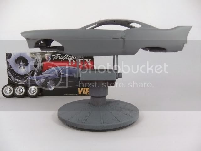

Another coat of primer and more wet sanding-
Possible sets of wheels to be considered pictured-
Tweeking of the side scoop...it's not round enough for my liking-

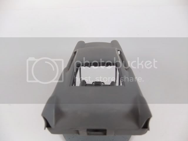

The outside of the roof line had some sharp edges from having sanded off the drip/wind rails previously so I rounded those over.
Still blending the rear deck- I filled in the whole rear arear around and above the Plate to the top of the trunk for a smoother look.
Each time I finish wet sanding with 3000 grit for a nice sheen and do the "look at it with a good light source" for odd reflections..then re-wet sand as needed, then follow up with a coat of primer and relook...wash, rinse, repete.......don't forget to rescribe those panel and door lines as you go along.
