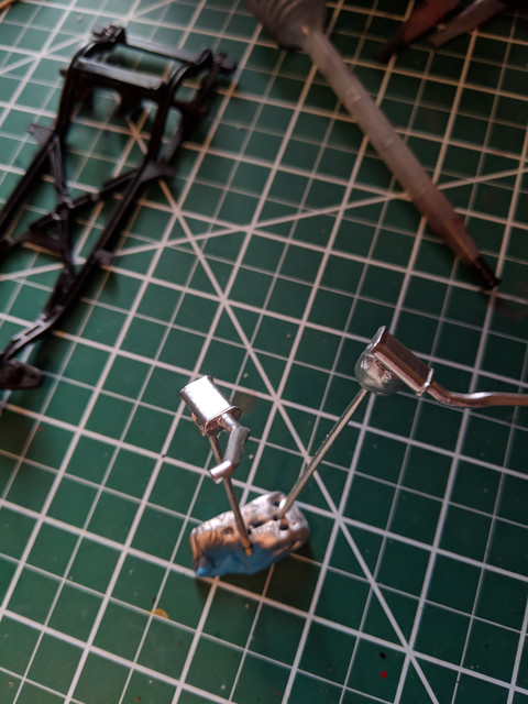

 By the original finish, I should have them done in BMF, but the space is too tight for my modeling knife, and probably I'm gonna end up picking them with a silver felt pen
Use a fresh No.11 blade. You'll be able to get into the spots near the windows with no difficulty. Also, when using BMF, having a mechanical pencil with 0.5 mm lead around is handy. The pencil lead is small enough to fit into any small crevices, allowing you to burnish the foil so it conforms to all of the details. When foiling side trim, scribing around the perimeter of the trim to create a recess will allow you to, in effect, tuck the foil into the recess and give the foiled trim a more realistic appearance.Personally like the stainless steel PE scribers from HQT Tools.
You can use the mechanical pencil to burnish the foil around the outer edges. The eraser on the mechanical pencil can be used to press the foil into scripts, badges and such without damaging these details.
