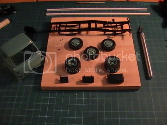

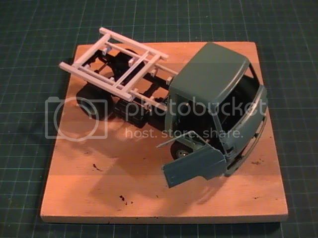

Made a start today on the Fujimi 1/32 Canter cab with scratch built mini skip loading equipment. I was hoping to give this to my brother as an Xmas present but it is likely that it might be the bare fabric by that time with a promise to complete.
It will be the thought that counts (I hope) and it spurs me on to submit something as update for campaign. Hope you like so far.

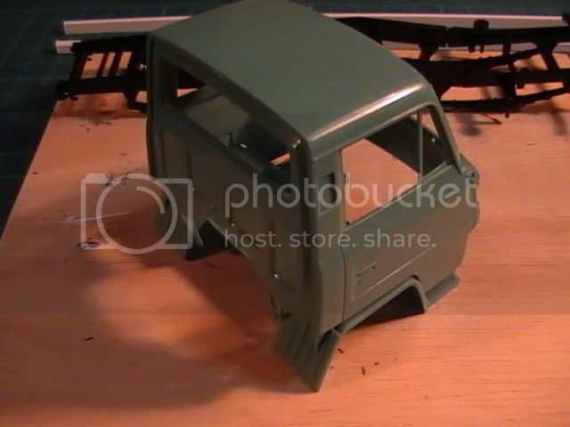

I haven't worked in 1/32 for a long while but the fujimi casting are really crisp and cleanly detailed.

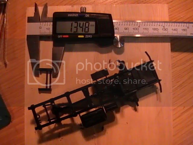

Dry fitting of parts was easy even though instructions in Japanese.

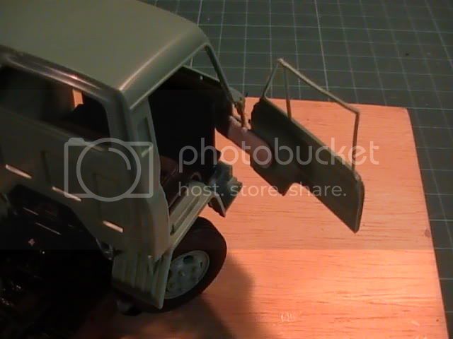

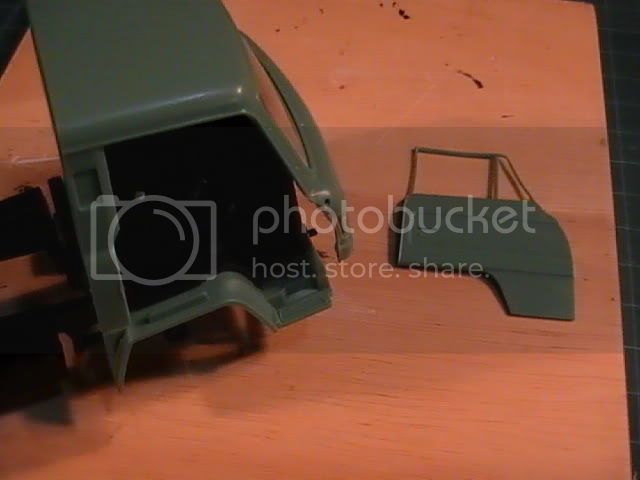

I have decided to scribe out the driver's door to place in open.
Soft plastic was easy to scribe
Will hopefully be easy to make up fixed hinges to show door

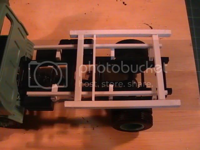

Chassis tail was cut down a fraction, just behind rear leaf spring hangers to match Cabstar's chassis
Front wheels are poseable and the tyres are a lovely rubber representation of Yokohama tyres.
Skip loader subframe was made up on plasticard sheet with temporary fixing to ensure parallel frames. Metal pensil sharpner was useful for keeping frames square internally.
Sub frame dry fit to chassis brackets to check progress.
How I left it tonight

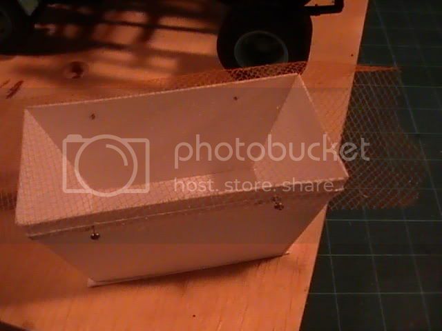

Started on the mini skips and made four
Still got the lugs to make for lifting chains to hitch to
Mini skips would make a nice addition to a modern military scene too and are dead easy to make

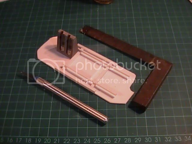

I forgot to take all necessary sizes on the loading arms so set this jig up to check by eye against photos and for operation
Got the sizes and angles first time with no hitch
arm sits nicely in over the middle of the skips

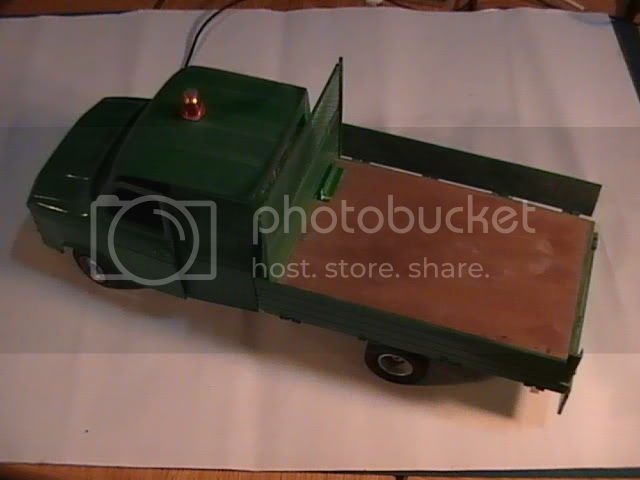

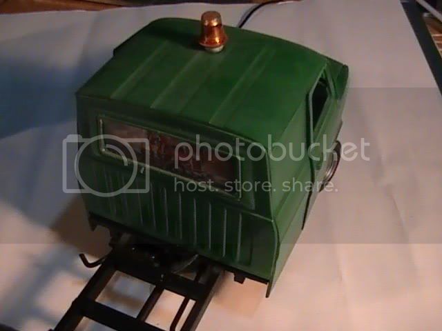

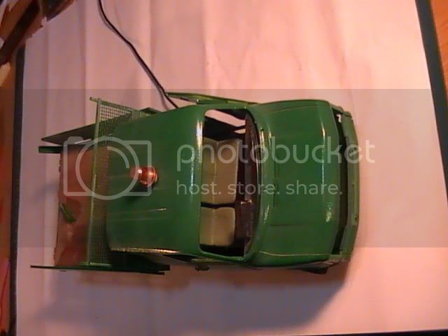

Photos of 1/24 Ford Transit as it currently stands
The cable runs to the walkman earphones inside to have music blaring from it.
Not happy with corner frames at rear
Back panel is the interior panel between load and cab moved to rear at cut and fitted fine
I still can't remember the kit the dual wheels came from (will find out when I go to build it someday)
Have to find the plans and remainder of parts so that I can get down to rebuild of certain areas etc

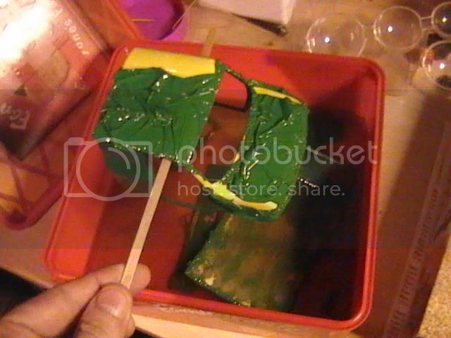

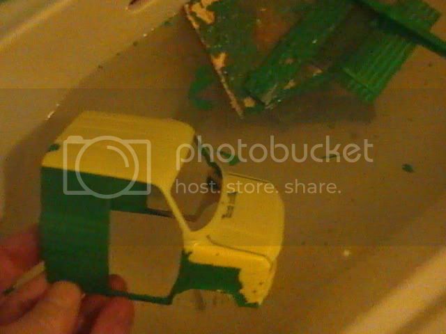

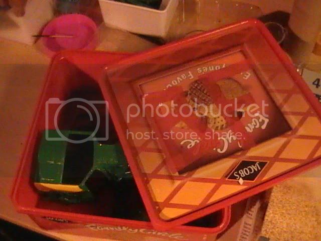

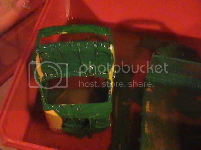

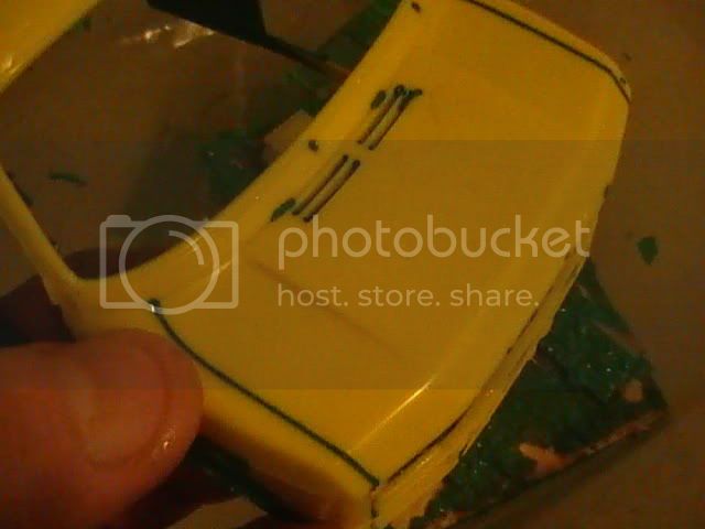

Has been too cold and windy hear in Scotland to do much in the shed without gas for my heater but wrapped well and did a little bit to justify my existance tonight.
Transit build
Gave the Transit van a bit of a bashing at the weekend and then dunked it in a biscuit box full of brake fluid,,,,,,,,,,,,,,,,,,,then had to dive about franticly looking for the plastic biscuit box I have used before when i suddenly remembered the tin box seams are not watertight. Silly bugger. The tin one is the one I use for spraying Mr Muscle in.
It looked like the soak had taken effect with me turning it occasionally over the week
How to get SWMBO totally anoyed,,,,,,,,,,,,,make a mess of the sink
The cab is going back in the brake fluid cause the cab did not soak up as much as I first thought even with a good hard scrub with the toothbrush
Parts all broken down again

Today I had the whole afternoon for modelling. So, finally take some time for my first planned entry in this campaign; the 1:32 scale '85 Daihatsu Mira Walkthrough Van from ARII:
A few weeks ago I tried to spray it with a rattle can of Tamiya Yellow (an old one I had in my garage for a few years...). Bad thinking!!!!!
The paint did not cover nicely and a orange skin appeared. Should have known bether...
So on the pictures below you can see some remaining yellow paint.
Also you can see I cutted the back door open. I had planned to cut the front door open also, but while cutting out the back door I noticed the styreen of this kit is very hard and brake off easy.
So, I'm afraid cutting out the front door would become a disaster. Unless ofcourse I build an entire new front door... Mmmmm....
The dashboard is painted in a real 'eighties' color
The wheels:
I decided to build the van as it come; like some sort of delivery van for ink-fish.
To make some cargo I scanned the ink-fish logo from the decals in my computer and I draw a simple box layout using a graphics program (actually, the good old 'Paint').
Than I pasted the ink-fish logo in the box drawing, did some editting and printed it on a brownish paper.
Now I just have to cut them out and glue it with Kids-glue and I have boxes full of (frozen or dried?) ink-fish!!!
Hope you all liked it this far!
