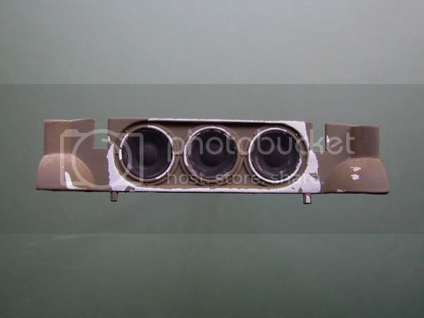

Today I tried painting the woofers in the trunk of funk but then failed on the masking ...
I'll have to strip and re-prime on this part.

First i think the seats look great, second did you try spraying a flat coat before masking that will help seal the paint, i also use a latex mask not tape.

I didn't top coat with anything. I had only Sunday off this week so I tried going too fast with it. The part is soaking in oven/grill cleaner now and I'll try again.
Is the latex mask a liquid mask? Good idea, I might need to try that. Thanks for the tip.

Yes i believe most masking agents are made of liquid latex it's like the same stuff rubber gloves are made of should not be expensive, i use a latex mold builder used for making molds this stuff is very expensive but i have had it for over 5 years it will last me at least another 5 years, i paint it on with any cheap old brush 2 coats works well.

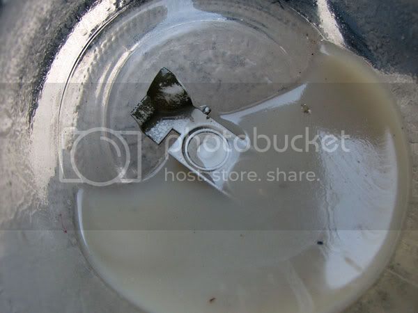

After soaking for 24 hours and gettng off work early enough, I started stripping. No, not me, the part from it's paint.
The oven/grill cleaner method works great. The paint is disolved but the styrene material is
untouched.
(gloves and eyes were used during this entire operation)
Here we are in the jar after agitation
after some picking and swishing around with an old toothbrush
part is freshly posed after scrub
part after scrub and rinse with tap water. ready for re-primer
I think I'll use
rv1963's liquid mask technique next try...

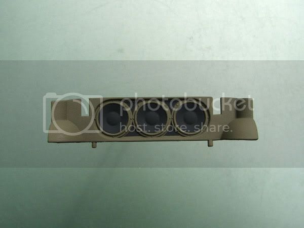

Well after the first attempt and total FAIL
I tried again with a different approach and it worked.
I'll add detail paint by hand, such as the screw heads

Nice recovery KSO....looking very good.

Nice recovery is correct!! What is the color of the interior on that speaker platform? Is that the overall interior color?
What did you have in mind for the speakers themselves? Were you going to put a speaker grill over those puppies, or just leave them open? (Honestly, I don't know how its done now-a-days, but still wanted to ask!)

The color will be OD. The speakers will be left as seen here.
Some lifted cars for shows are themes. This is going to be Seabees "We Build, We Lift, Can Do" or something like that.

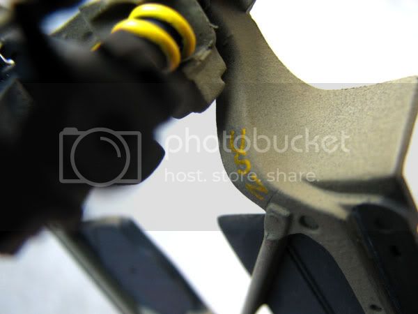

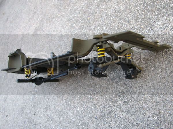

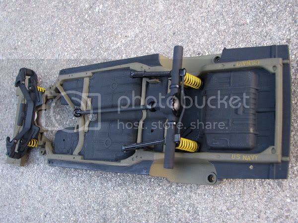

The chassis frame and bottom pan was painted today, a few touch ups to follow.
Wheels are also painted and done.

...ya could do a "natural metal" look with panel lines and AB'd rivets..........could.......

Yeah, now I'm startin' to get a feel for the Donk! And you even got the branch right!!
