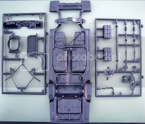

Talking to someone at work today, reveals that the lifted cars do not have any hydrolics. They don't have the option to slam down and tuck the wheels. The cars are just lifted.
So, some of the parts above on the sprues are extras, like the battery pack and hydro pumps.
Also, I don't need to plumb any of it, because it's not on a real car anyway.
